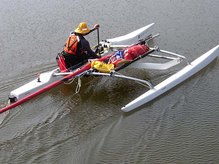

Having a large and weirdly-proportioned body, I never expect anything to fit out-of-the-box unless built custom, and the used OC-1 sailing canoe I just took delivery on did not disappoint in that respect.
I moved the pedals forward about 1.5" and the seat back an inch - and that made things tolerable.
But now it has dawned on me that maybe elevating the seat might help too.
Putting a 1" pad under the seat seems to have raised my hips relative to the knees as expected and, as soon as the water around here is no longer hard, I expect to find out if it's good for anything.

FWIW, here's the beast just bought:

I actually did this on a Storm OC1 at the end of the 2015 season (winter in CT).
It worked for me - 6'4" and 240lbs so was looking for anything to help me out (other than losing 20lbs that would be most logical!). I was definitely quicker over longer distances and also sprinting to get on waves here - seemed to allow more drive into the heel and i think that, for a taller guy, having the knee CLOSE to being below the ass, helped. I reckon that doing distance paddling, and your pics indicate you are, it's worth a shot - but do something temporary just to get a feel for it.
I've owned many OC1's (Scorpius, Storm, Antares here in US - and paddled most others) so have a rough idea of how it all works. At least for an English......
Happy to share other thoughts on it if you need.
Best wishes
Ted
