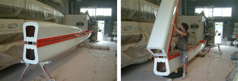

Yes you read right, a Mirage OC6 that folds in two! Peter and I hope that this could be one solution to the trailer legality issues facing clubs here in Australia. For more photos and details visit the Outrigger Connection AUS website

Interesting concept. Does it work? Is there a gasket at the connection, to make it water tight? What is the finished weight?

The hull of the folding Mirage weighs 155kg or about 340lb. There is a rubber gasket still to be added, see attached photo, which makes it water proof . We've made quite a few 3 piece Mirages for Hong Kong and Japan because firstly, they don't have a lot of storage space for a 45' canoe and secondly, their roads are so narrow and twisty they can't manoeuvre a full length trailer.
