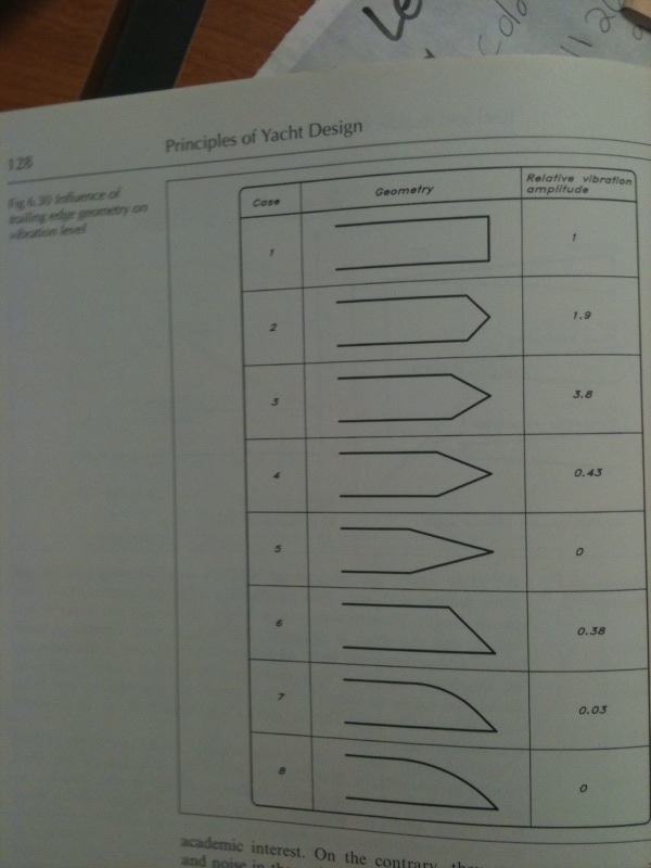

kawaikapu,
The vibration comes from a complicated interaction between the flow and the rudder. Without fundamentally changing the design of the rudder, the easiest way to fix it is like everyone else said -- alter the trailing edge. Attached is an image from Larsson and Eliasson, Principles of Yacht Design about how the trailing edge influences vibration levels. Typically all the rudders out of Kamanu Composites are beveled similar to case 7 or 8. This seems to have fixed the problem in most cases, but clearly not all. You can do it yourself, just use some 220 grit sandpaper and a block. But be careful not to sand too much. If you go through the carbon, you could end up ruining your rudder.
http://www.ocpaddler.com/files/rudder_trailing_edge_vibration.jpg
