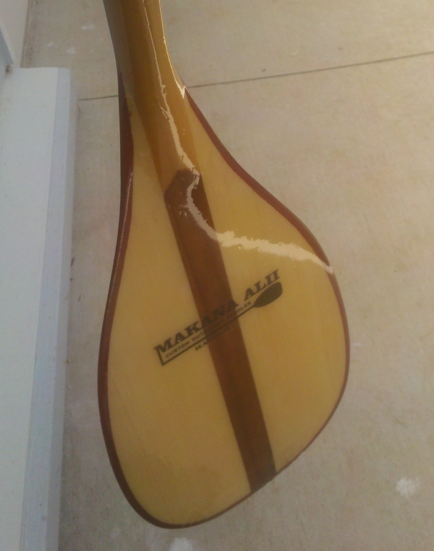

I'm wondering if anyone knows if the Makana Alli paddles are coated with varnish or an epoxy? I need to do some repair to my paddle which will include some fiber glass cloth -- the bottom edge has a split in the wood.
I recoated a previous paddle, that was flaking with Epifanes varnish and it came out so beautiful (about 3 coats). I guess I'm just wondering if you can mix the epifanes and the epoxy? I'm assuming I have to use epoxy for the glass job. But, I also need to refinish the shaft and was thinking to use the varnish.
Anyone have experience or ideas?

Thanks isotopez, I went out and got some epoxy and sanded her down. I hope I can get the repair stiff enough to hold up. I left just a few bumps as I'm sure there are some ladies that like the bumby shafts...

A little follow up for people wanting to fix their own paddles. If you are going to lay any fiber cloth then do not hang the paddle. I would only hang the paddle for a final coat. The problem is that, with the paddle hanging, the fiber cloth will not stay put. It will eventually slide completely off the blade. My suggestion is to work with the fiber cloth area first, when repairs are done, then do a final coat that includes everything.
The gentleman at the store said I should use polyester resin. I'm very glad I didn't listen and went with the epoxy. I can feel it setting up very strong. I am hoping my Makana Ali'i will have a beautiful new life.

It was pretty heavy, It was a fiberglass "tape" so I imagine around 10 oz! The plan was to cover the bottom two inches on the face. Anyway, the tape kept sliding and i kept scooting it back up. When I left and came back it had completely fallen. So, I'm putting another coat and trying it without the tape. If that doesn't work I will go back and just do the tape. But the epoxy alone seems really strong.
I guess I will put a third coat of something with UV protection. I've read that yacht builders are now putting coats of epoxy then coats of varnish on top for wood. I believe varnish is UV protected. Maybe I will put one coat of varnish, or, just get something in a spray can.
