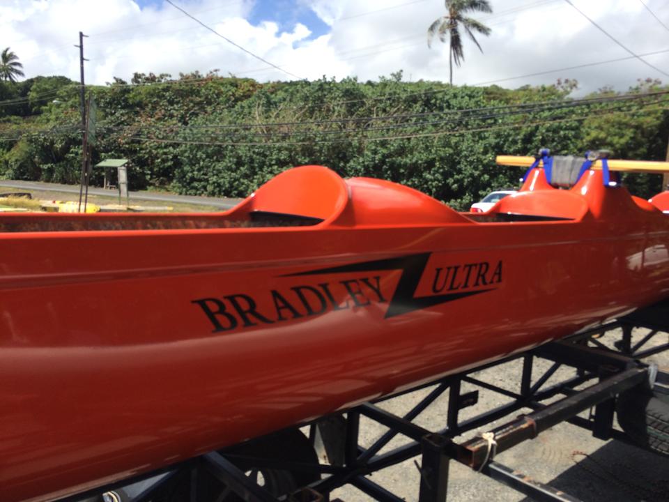

my buddy told me to check out these pictures on Facebook. what you guys think? Looks like Sonny is officially making non spec canoes too…

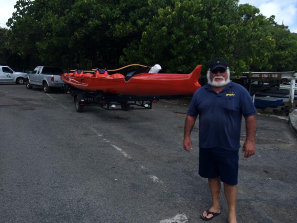

couple more pictures i saw this AM, they show the hull a bit.
#4 Thu, 07/31/2014 - 6:47am
The first image shows the bow....interesting what is going on there. That seems to be a real departure from other designs. Any thoughts on it ?
#5 Thu, 07/31/2014 - 7:58am
The canoe in the image is the plug and a mold has already been made!

The orange ... Tooling gelcoat ?

You're correct, Its orange tooling gelcoat.

You can't really see it in the photos but did anyone notice that the Ultra has a real Pale Kai instead of a small ridge?
What about the cockpits and gunnels? You can actually do a change in this canoe without having to grab 6 plus inches higher and when you hit the seat you won't be gouging your back into what is basically a gunnel on the back of the cockpit. The lines in front of the cockpit channel water away from your lap instead of into your lap. Also check out the wais. They can be rigged traditionally with line or with quick straps.
The effort put into keeping tradition alive while advancing canoe design is unbelievable. Who ever thought you would see a manu, pale kai, and traditional rigging on an unlimited? I thought we would only see giant one mans with aluminum iakos.
I can't wait to see how the new ama and iakos will look. Right now it looks like he's using the Iolana ama with modified wood iakos to adjust for the height of the wais.
