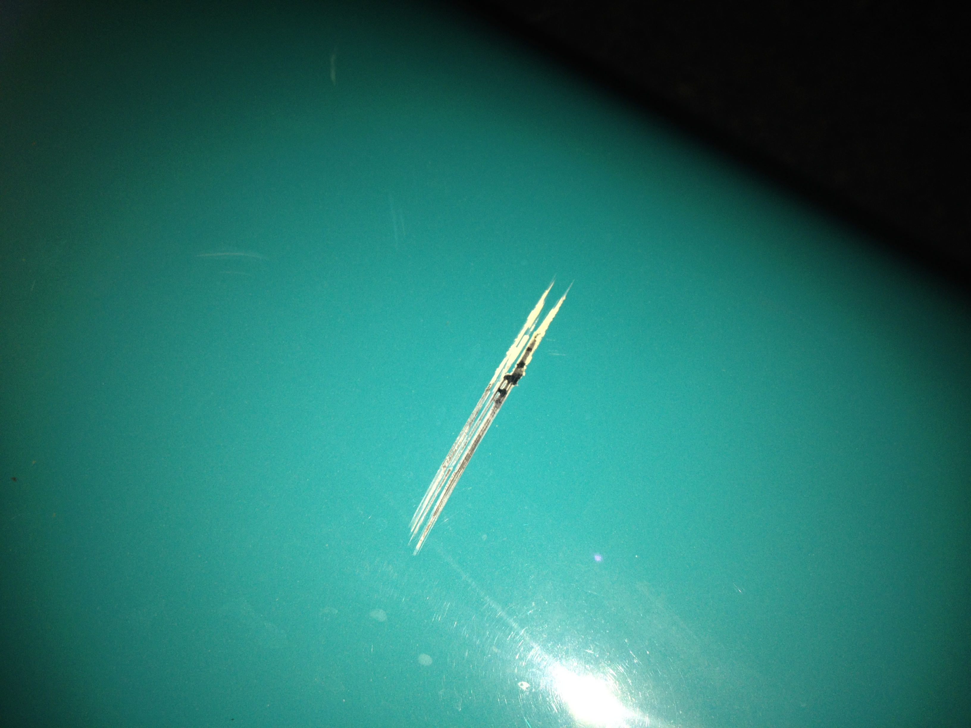

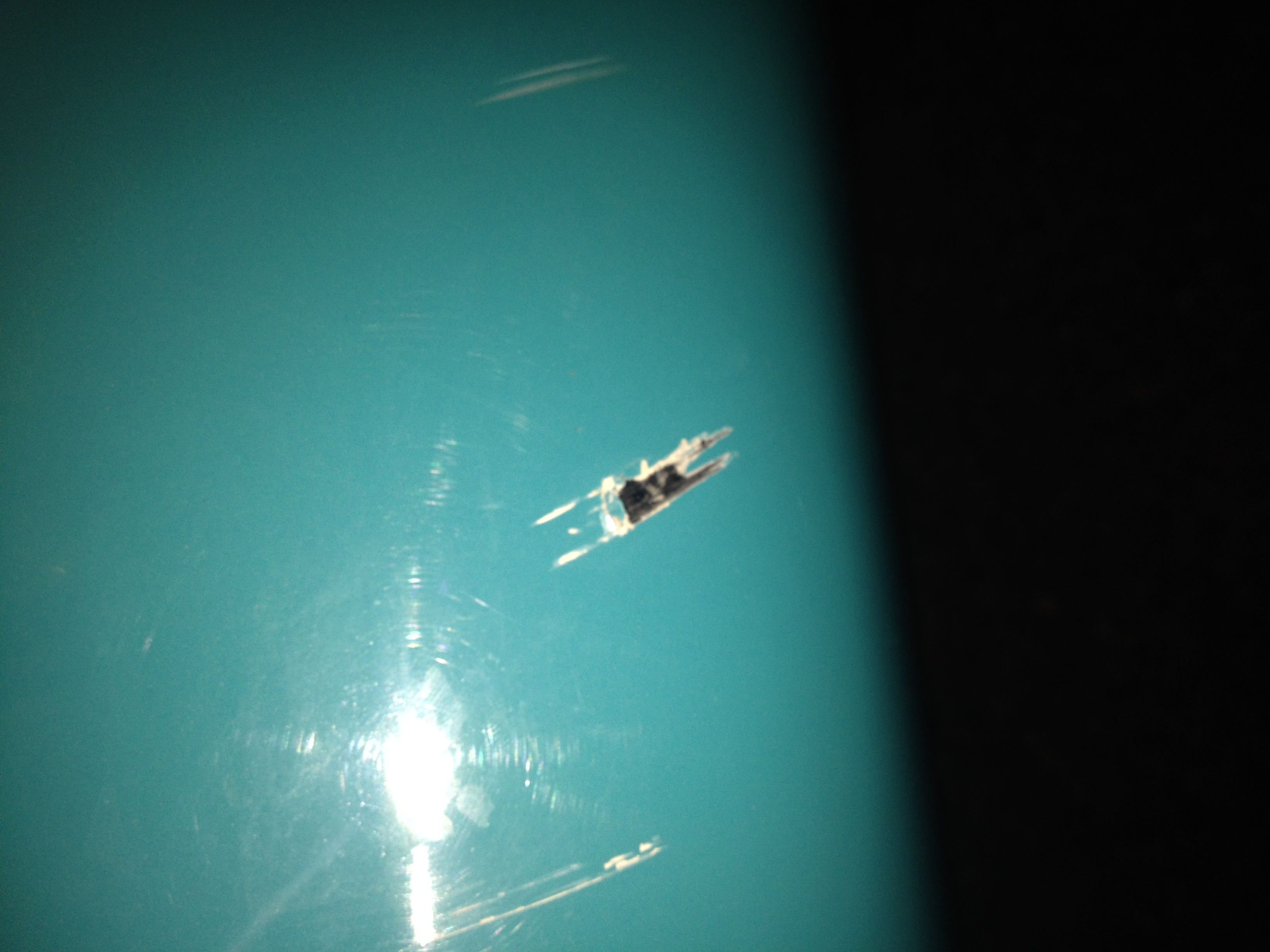

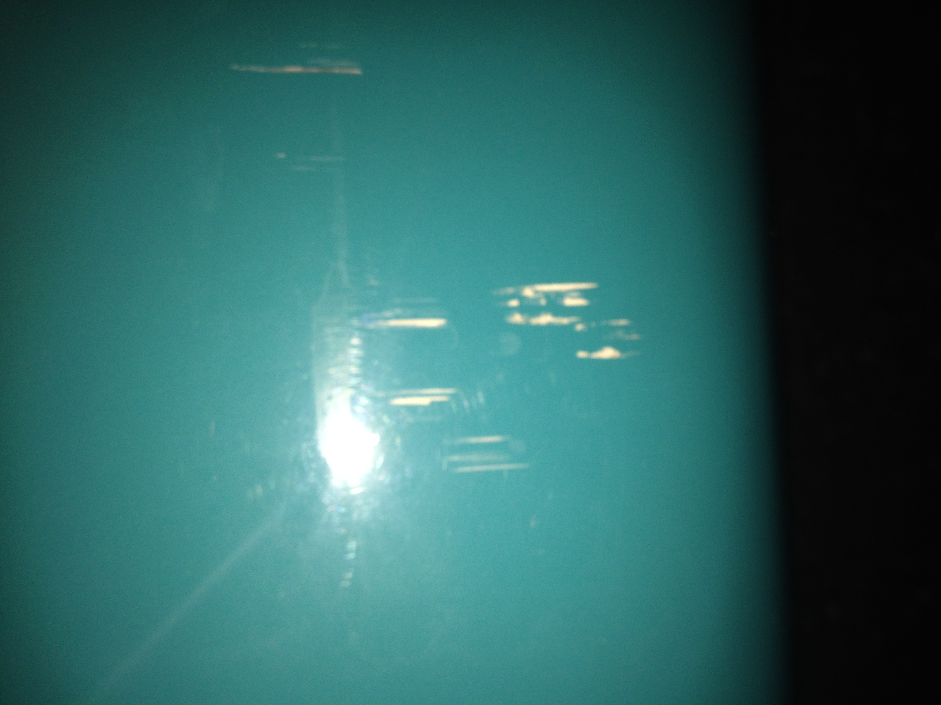

Boat was scraped a bit over barnacles during race this weekend- through the paint and exposed carbon.
Does anyone have any recommendations on how to repair and which materials to use?

Minor damage, though it may suck in some water.
Thickened resin will make a nice patch.
Sand lightly first with a 150 grit sand paper. The tape the area and apply the resin.
Re sand with 220 softly, to remove edges. Then use 320. 400 600 and polishing compound for shine.
If you use pigments you could perfectly match the color!
Good luck
